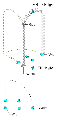

Door dimension grips

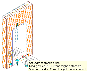

Many grip tooltips contain additional information on how to use the grip.
Displaying the tooltip for door standard size
