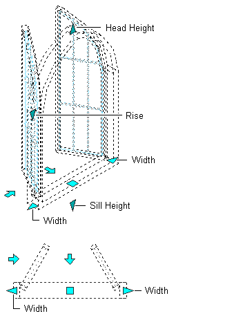

Window dimension grips in Plan view and Model view

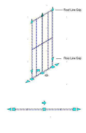

Curtain wall grips in Plan view and Model view
