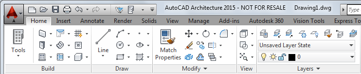

Similarly to Microsoft Office, AutoCAD Architecture uses the ribbon as the central access point for commands. The ribbon contains a number of tabs on which commands are grouped according to conceptual task types or selected objects.
The ribbon replaces the menu bar and the toolbars as the primary command access point.
The application menu contains basic commands pertaining to the drawing as a whole, such as Open, Save, Print, and Export. Like the menu browser it replaces, the application menu is accessed by clicking
in the upper-left corner of the workspace.
AutoCAD Architectures equipped with one single default workspace (Architecture). The menus and commands associated with the previously provided workspaces (Design, Document, Detailing, and Visualization) can be accessed from the tabs of the ribbon.

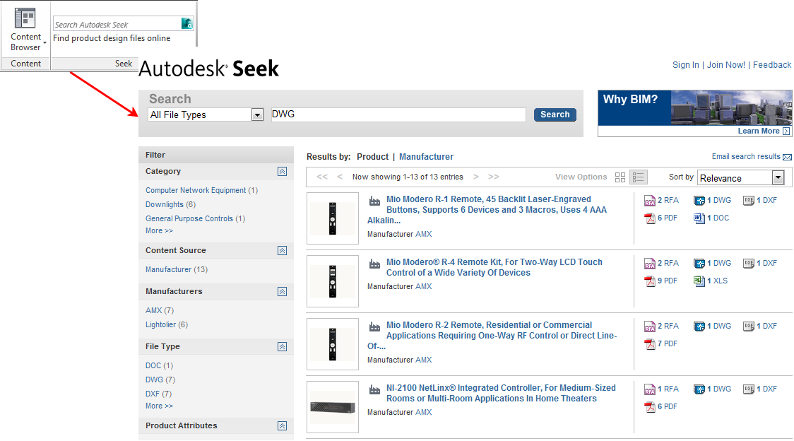

You can use Autodesk Seek to find product design information. Many content providers, both corporate partners and individual contributors, publish to Autodesk Seek. Content includes 3D models, 2D drawings, specifications, brochures, and other descriptions of products or components.
Import design content into AutoCAD Architecture
You can also share your own content with others using Autodesk Seek. Upload drawings or blocks to Autodesk Seek to give your partners and customers ready access to your content.
