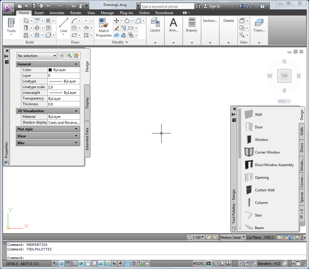

Provides an overview of the available workspace components and describe how to access and configure them to meet your needs.
In AutoCAD Architecture, a workspace is the basic user interface that includes those controls, commands, and palettes you need for your architectural process. When you first start AutoCAD Architecture, the default Architecture workspace is displayed.
You can reconfigure the workspace according to your preferences as you work. You can move or hide various components as needed, display additional ribbon controls, or add new tools and tool palettes. If desired, you can save your customization as a new workspace that you can access for later drawing sessions. You can also switch from one workspace to another at any time.
Default configuration of the AutoCAD Architecture workspace
