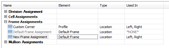

Use this procedure to add a frame assignment to a door/window assembly. To assign different definitions to different frame edges, you need multiple frame assignments.
Door/Window Assembly Styles.
. A new frame assignment is displayed in the list of frame assignments.
