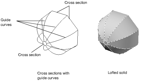

Specifies guide curves that control the shape of the lofted solid or surface. You can use guide curves to control how points are matched up on corresponding cross sections to prevent undesired results, such as wrinkles in the resulting solid or surface.
  • Intersects each cross section
  • Starts on the first cross section
  • Ends on the last cross section
Select any number of guide curves for the lofted surface or solid and press Enter.

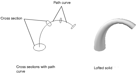

Path
Specifies a single path for the lofted solid or surface.
The path curve must intersect all planes of the cross sections.
