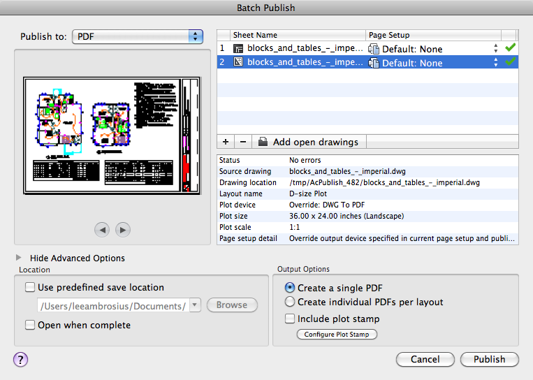

Batch Publish Dialog Box
Specifies drawing sheets that you can assemble, reorder, and publish as a multi-sheet drawing set.
Summary

Preview
Displays a preview of the selected layout in the Sheet list. Click the Next and Previous buttons to preview another layout in the Sheet list.
Sheet List
Contains the list of drawing sheets to be included for publishing. Click the page setup column to change the sheet’s settings. Use the shortcut menu to add sheets or make other changes to the list.

Sheet Details
Displays the following information about the selected sheet: status, source drawing, drawing location, layout name, plot device, plot size, plot scale, and page setup details.

PDF Options
The following options are specific to publishing to a PDF file.
Show/Hide Advanced Options
Displays additional options that are available when publishing to PDF files.
Location
Specifies the location to save the PDF file to and display the PDF when publishing is complete.
Use Predefined Save Location
Specify the default location to save the PDF files to. When publishing to a single PDF file, you can specify the location of the file after clicking Publish as well.
Open when Complete
When publishing completes, the PDF file will open in a viewer application.
Output Options
Specifies how the layouts should be output for PDF files and if a plot stamp is included on each layout.
Create a Single PDF
A multi-sheet PDF file is created that contains all the layouts in the Sheet list.
Create individual PDFs per Layout
A single PDF file is created for each layout in the Sheet list.

Publish
Starts the publishing operation.
To display information about the published sheets, including any errors or warnings, click the Plotting Details Report message balloon to displays the Print Details dialog box. This information is also saved to the Plot and Publish log file.
