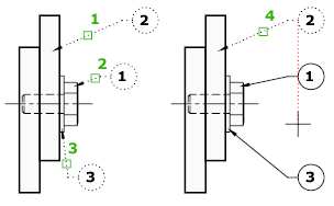

After multileaders have been selected, specify the multileader to which all others are aligned.
List of Prompts
The following prompts are displayed.
Select multileader to align to or [Options]:
Options
Specifies options for aligning and spacing the selected multileaders.
Distribute
Spaces content evenly between two selected points.
Make Leader Segments Parallel
Places content so that each of the last leader segments in the selected multileaders are parallel.
Specify Spacing
Specifies spacing between the extents of the content of selected multileaders.
Use Current Spacing
Uses the current spacing between multileader content.
