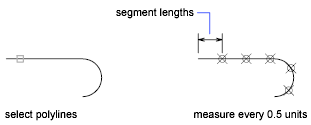

The illustration shows how MEASURE marks 0.5-unit distances along a polyline, with the PDMODE system variable set to 35.
