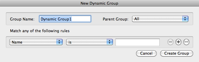

New Dynamic Group Dialog Box
Groups layers based on the criteria you select.

Group Name
Provides a space to enter a name for the layer group.
Parent Group
Displays a list of all the layer groups that the new dynamic layer group can be nested under.
Rules
Displays the properties of layers. You can use one or more properties to define the layer group. For example, you can define a layer group that displays all layers that are either Red or Blue and in use. To include more than one color, linetype, or lineweight, add another rule and select a different setting.

Layer
Selects Used or Not-Used layers in Model space or a viewport.
Remove Rule
Removes a single rule or a grouping of rules.
Create Rule Group
Creates an And grouping of rules. Grouping rules allows you to make complex filters.
Add Rule
Adds a new rule. Use the new set of controls to specify the layer properties and conditions for the rule.
Create Group
Adds the new dynamic group to the Layers palette.
