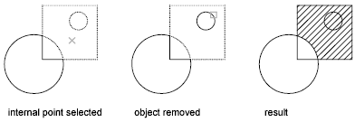

Add: Pick Points
Determines a boundary from existing objects that form an enclosed area around the specified point.
If you turn on Island Detection, objects that enclose areas within the outermost boundary are detected as islands. How HATCH detects objects using this option depends on which island detection method is specified.
