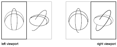

Specifies the projection method used when extending objects.

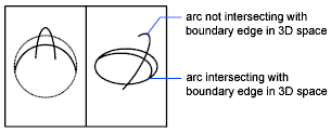

None
Specifies no projection. Only objects that intersect with the boundary edge in 3D space are extended.

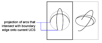

UCS
Specifies projection onto the XY plane of the current user coordinate system (UCS). Objects that do not intersect with the boundary objects in 3D space are extended.
View
Specifies projection along the current view direction.
