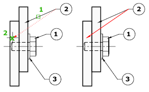

Specify leader arrowhead location or [Remove Leaders]
Add Leader
Adds a leader line to a selected multileader object. The new leader line is added to the left or right of the selected multileader, depending on the location of the cursor.
Remove Leaders
Removes a leader line from a selected multileader object.
For example:
