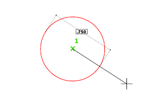

Center Point
Draws a circle based on a center point and a diameter or a radius.
Radius
Defines the radius of the circle. Enter a value, or specify a point.
For example:
Diameter
Defines the diameter of the circle. Enter a value, or specify a second point.
For example:
