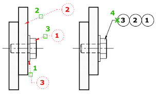

Organizes selected multileaders that contain blocks into rows or columns, and displays the result with a single leader.
Button
Toolbar: Annotation tool set
Leaders tool group
Collect Leaders
Menu:
Modify
Object
Multileader
Collect
After you select multileaders, you can specify their placement.
For example:
The following prompts are displayed.
Specify collected multileader location or [Vertical/Horizontal/Wrap]
Specifies the point for placing the multileader collection in the upper-left corner of the collection.
Places the multileader collection in one or more columns.
Places the multileader collection in one or more rows.
Specifies a width for a wrapped multileader collection.
