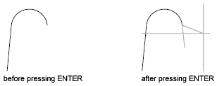

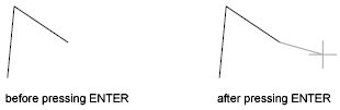

Specify first point: Specify a point or press Enter to continue from the last drawn line or arc
Specify next point or [Close/Undo]:
Continue
Continues a line from the endpoint of the most recently drawn line.
If the most recently drawn object is an arc, its endpoint defines the starting point of the line, and the line is drawn tangent to the arc.

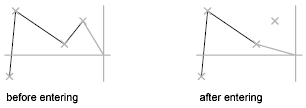

Close
Ends the last line segment at the beginning of the first line segment, which forms a closed loop of line segments. You can use Close after you have drawn a series of two or more segments.
Undo
Erases the most recent segment of a line sequence.
Entering u more than once backtracks through line segments in the order you created them.
