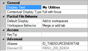

  4. Select the new ribbon tab in the tree view, and update the Properties pane:
    • In the Display Text box, enter a text string for the ribbon tab's title that should appear on the ribbon.
    • In the Contextual Display Type box, specify how the ribbon tab should be displayed on the ribbon when used with a contextual ribbon tab state.
    • In the Default Display box, specify if the ribbon tab should be displayed by default when the CUIx file is loaded as a partial customization file.
    • In the Workspace Behavior box, specify if the ribbon tab is merged or added to the ribbon when the CUIx file is loaded as a partial file.
    • In the KeyTip box, enter a text string that can be used to access the ribbon tab from the keyboard when the Alt key is pressed.
    • In the Aliases box, enter an alias for the ribbon tab.
