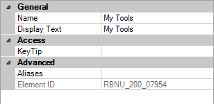

Create a Ribbon Panel
  1. In the Customize tab, Customizations In <file name> pane, click the plus sign (+) next to the Ribbon node to expand it.
  2. Right-click the Panels node. Click New Panel.
    A new panel (named Panel1) is placed at the bottom of the Panels node.
  3. Right-click Panel1. Click Rename and enter a new panel name.
  4. Select the new panel, and update its properties in the Properties pane:
    • In the Display Text box, enter the text you want to display for the title of the panel when it is displayed on the ribbon.
    • In the KeyTip box, enter the characters to access the ribbon panel from the keyboard when Alt is pressed.
    • In the Aliases box, enter an alias for the ribbon panel.
  5. Click Apply.

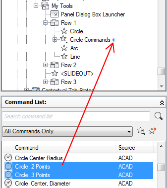

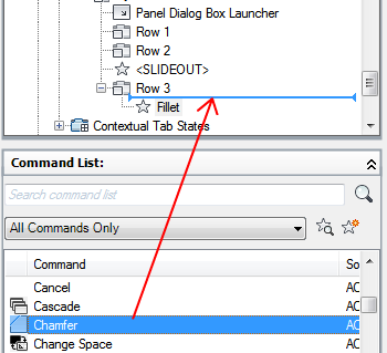

Add a Command
  2. Click the plus sign (+) next to the Panels node to expand it.
  3. Click the plus sign (+) next to the ribbon panel where you want to add a command.
  4. Click the plus sign (+) next to the rows, sub-panels, or drop-downs to get to the location you want to add a command.
  5. Drag and drop a command from the Command list to a row, sub-panel, or drop-down on the panel.

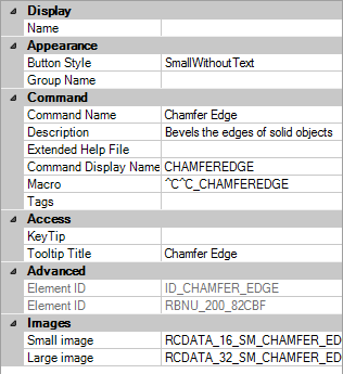

  6. In the Properties pane, change the properties of the command you added.
  7. Click Apply.

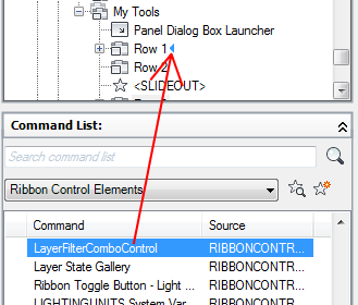

Add a Control
  3. Click the plus sign (+) next to the ribbon panel where you want to add a control.
  4. Create a new row for the control if you need to, or click the plus sign (+) next to the row where you want to add a control.
  5. In the Command List pane, Categories list, select Ribbon Control Elements.
    The Command list displays the list of ribbon control elements only.
  6. Drag and drop a control from the Command list to a row in the ribbon panel.
  7. Click Apply.

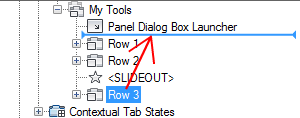

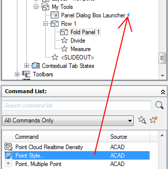

Assign a Command to the Panel Dialog Box Launcher
  3. Click the plus sign (+) next to the ribbon panel where you want to assign a command to its Panel Dialog Box Launcher node.
  4. Drag a command from the Command list to Panel Dialog Box Launcher on the panel.
  5. Click Apply.

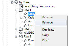

Remove a Command or Control
  3. Click the plus sign (+) next to the ribbon panel where you want to remove a command or control.
  4. Click the plus sign (+) next to the rows, sub-panels, or drop-downs to get to the location you want to remove a command or control.
  5. Right-click the command or control that you want to remove. Click Remove.
  6. Click Apply.

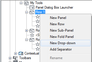

Create a Drop-down in a row
  3. Click the plus sign (+) next to the ribbon panel where you want to add a drop-down.
  4. Right-click the row to which you want to add a drop-down. Click New Drop-down.
    A new drop-down (named New Drop-down) is created in the last position of the row.
  5. Right-click the new drop-down. Click Rename and enter a new name.
  6. From the Command List pane, drag and drop the commands that you want to add to the new drop-down.
  7. Adjust the properties of the drop-down as desired to control the appearance of the drop-down and the commands under the drop-down.
  8. If the drop-down will use the Split behavior, add a command to the Primary Command node under the drop-down to set the command for the main button.
  9. Click Apply.

  5. Select the command that you want to show its label for.
  6. In the Properties pane, Button Style box, click the down arrow and select Large With Text (Vertical), Large With Text (Horizontal), or SmallWithText.
  7. Click Apply.
Set the Size of a Command or Drop-down
  3. Click the plus sign (+) next to the ribbon panel which has the command or drop-down for which you want to set the size.
  4. Click the plus sign (+) next to the row or sub-panel that has the command or drop-down for which you want to set the size. If you need to, continue expanding rows, sub-panels, and drop-downs to get to the command or drop-down.
  5. Select the command or drop-down for which you want to set the size.
  6. In the Properties pane, Button Style box, click the down arrow and select Large With Text (Vertical), Large With Text (Horizontal), SmallWithText, SmallWithoutText, or LargeWithoutText.
  7. Click Apply.

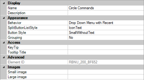

Set the Button Style of a Drop-down
  3. Click the plus sign (+) next to the ribbon panel where you want to change the style of a drop-down.
  4. Click the plus sign (+) next to the row or sub-panel that contains the drop-down you want to change. If you need to, continue expanding rows and sub-panels to get to the drop-down.
  5. Select the drop-down that you want to change, and update its properties in the Properties pane:
    • In the Behavior box, click the down arrow and select Drop Down Menu with Recent, Drop Down Menu, Split with Recent, Split, or Split with Recent (Static).
    • In the Split Button List Style box, click the down arrow and select Icon, Icon and Text, and Descriptive.
  6. Click Apply.

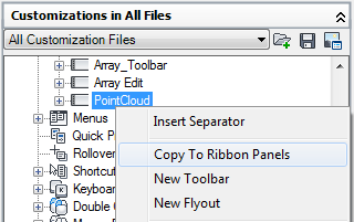

Copy a Toolbar to a Ribbon Panel
  1. In the Customize tab, Customizations In <file name> pane, click the plus sign (+) next to the Toolbars node to expand it.
  2. Right-click the toolbar that you want to copy and convert to a ribbon panel. Click Copy to Ribbon Panels.
  3. In the CUI Editor - Confirm Copy to Ribbon Panels Node dialog box, click Yes.
    The copied toolbar is placed under the Ribbon Panels node.
  4. Click Apply.

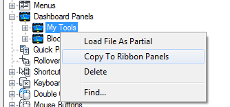

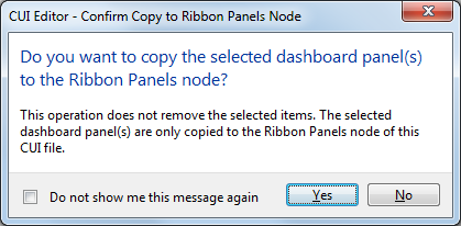

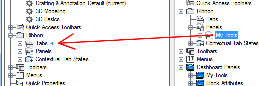

Copy a Dashboard Panel to a Ribbon Panel
  1. In the Transfer tab, Customizations In <file name> pane on the right side, click the Open Customization File button.
  2. In the Open dialog box, Files of Type drop-down list, select Legacy Customization Files (*.cui).
  3. Browse to and select the customization (CUI) file that contains the dashboard panels you want to copy to ribbon panels. Click Open.
  4. Click the plus sign (+) next to the Dashboard Panels node to expand it.
  5. Right-click over the dashboard panel you want to copy and convert to a ribbon panel. Click Copy to Ribbon Panels.
  6. In the CUI Editor - Confirm Copy to Ribbon Panels Node dialog box, click Yes.
    The copied dashboard panel is placed under the Ribbon Panels node.
  7. Drag the new ribbon panel from the Customizations In <file name> pane on the right side to the Panels node of a loaded CUIx file in the Customizations In <file name> pane on the left side.
  8. Click Apply.
