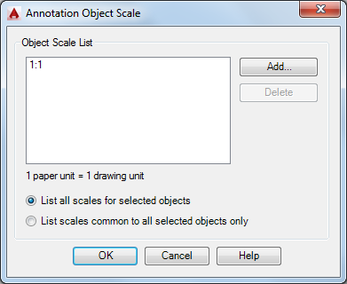

Adds or deletes supported scales for the selected annotative object.
The following options are displayed.
Displays the list of scales supported by the selected object.
Specifies that all scales supported by the selected objects are displayed in the Object Scale List.
Specifies that only the supported scales that are common to all selected objects are displayed in the Object Scale List.
Displays the Add Scales to Object Dialog Box.
Removes the selected scale from the scale list.
