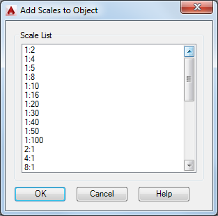

Adds a new scale to the selected annotative object.
The following option is displayed.
Displays the list of scales that can be added to the selected annotative object.
Multiple scales can be selected by holding down the Shift or Ctrl key while selecting the scales.
Use the SCALELISTEDIT command to add custom scales to this list.
