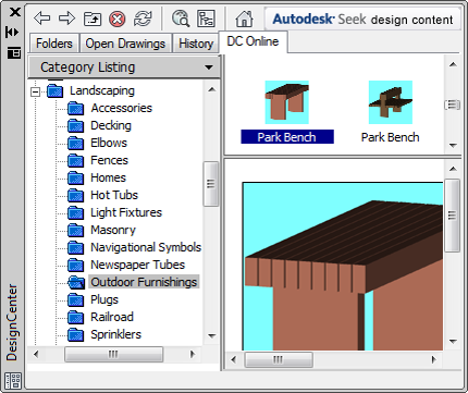

DesignCenter Online provides access to content such as blocks, symbol libraries, manufacturers' content, and online catalogs. This content can be used in common design applications to assist you in creating your drawings.
To access DesignCenter Online, click the DC Online tab in DesignCenter. Once the DesignCenter Online window is open, you can browse, search, and download content to use in your drawing.
You choose the view by clicking the heading at the top of the left pane.
Once you make a selection, the content is loaded into the content area on the right. You can select an item in the content area to display it in the preview area. Items can be downloaded by dragging them from the preview area into your drawing or tool palette, or by saving the items to your computer.
