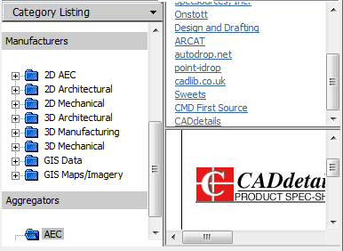

When you use the Category Listing view, you can click the folders in the left pane to view their contents. These folders may contain other folders.
When you click a folder or an item inside a folder, the contents are displayed in the Content area. When you click a block, graphical and descriptive information about the block is displayed in the preview area.

You can choose the type of content to navigate and search. In the Collections pane, you can specify the content types that are displayed each time you open DesignCenter Online. For example, if you use architectural blocks in your drawings, you select collections that contain architectural items. Once you make your selection, categories that you specified are displayed.
To download content from the Web, locate the folder containing the content that you want to use. Then, click a thumbnail image of the content in the content area. The content is displayed in the preview area along with information about the content. You can drag the block directly from the preview area into a drawing or tool palette, or you can save it to your computer to be used later.
