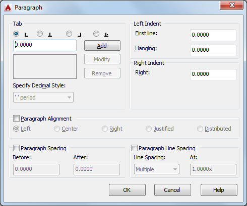

Sets indentation for paragraphs and the first lines of paragraphs.
Specifies tab stops, indents, controls paragraph alignment, paragraph spacing, and paragraph line spacing.
The following options are displayed.
Displays tab setting options, including adding and removing tabs. Options include setting left, center, right, and decimal tabs. You can also set tabs from the Tab selection button on the In-Place Editor’s ruler.
Sets the decimal style based on current user locale. Options include setting the decimal style as period, comma, and space. This setting is preserved with the drawing even if the locale setting is changed.
Sets the indent value for the first line or hanging indent to the selected or current paragraphs.
Applies the indent to the entire selected or current paragraph.
Sets the alignment properties for the current or selected paragraphs.
Specifies the spacing before or after the current or selected paragraphs. The distance between two paragraphs is determined by the total of the after paragraph spacing value of the upper paragraph and the before paragraph spacing value of the lower paragraph.
Sets the spacing between individual lines in the current or selected paragraphs.
