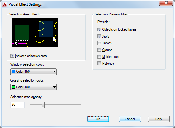

Controls the appearance of selection previewing.
Options dialog box, Selection tab
The following options are displayed.
Controls the appearance of selection areas during selection preview.
Displays the effect of the current settings.
Controls the display of effects for selection areas. (SELECTIONAREA system variable)
Controls the color of the transparent selection area during window selection. (WINDOWAREACOLOR system variable)
Controls the color of the selection area during crossing selection. (CROSSINGAREACOLOR system variable)
Controls the transparency of the selection area during window and crossing selection. (SELECTIONAREAOPACITY system variable
Specifies the object types which are excluded from selection previewing.
Excludes objects on locked layers from selection previewing. This option is on by default. (PREVIEWFILTER system variable)
Excludes objects in xrefs from selection previewing. This option is on by default. (PREVIEWFILTER system variable)
Excludes tables from selection previewing. (PREVIEWFILTER system variable)
Excludes objects in groups from selection previewing. (PREVIEWFILTER system variable)
Excludes multiline text objects from selection previewing. (PREVIEWFILTER system variable)
Excludes hatch objects from selection previewing. (PREVIEWFILTER system variable)
