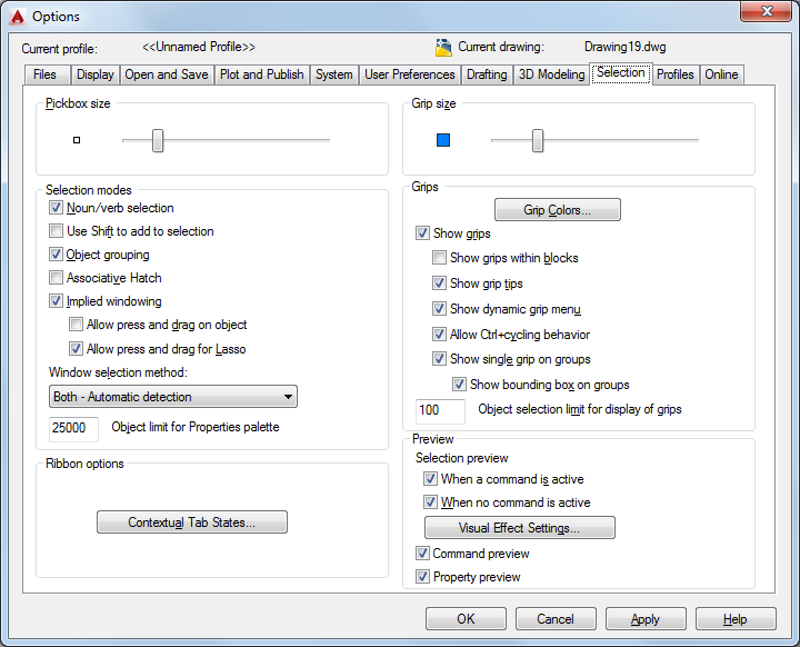

Sets options for selecting objects.
The following options are displayed.
Sets the object selection target height, in pixels. (PICKBOX system variable)
The pickbox is the object selection tool that appears in editing commands.
Controls settings that relate to object selection methods.
Controls whether you select objects before (noun-verb selection) or after you issue a command. (PICKFIRST system variable)
Many but not all editing and inquiry commands support noun/verb selection.
Controls whether subsequent selections replace the current selection set or add to it. (PICKADD system variable)
To clear a selection set quickly, draw a selection window in a blank area of the drawing.
Selects all objects in a group when you select one object in that group. With GROUP you can create and name a set of objects for selection. (PICKSTYLE system variable)
Determines which objects are selected when you select an associative hatch. If this option is selected, boundary objects are also selected when you select an associative hatch. (PICKSTYLE system variable)
Initiates the drawing of a selection window when you select a point outside an object. (PICKAUTO system variable)
Drawing the selection window from left to right selects objects that are entirely inside the window's boundaries. Drawing from right to left selects objects within and crossing the window's boundaries.
Controls the window selection method. (PICKAUTO system variable)
If this option is cleared, you can draw a selection window by clicking two separate points with the pointing device.
If this option is checked, you can draw a selection lasso by clicking and dragging with the pointing device.
Use the dropdown list to change the PICKDRAG system variable setting.
Determines the limit of the number of objects that can be changed at one time with the Properties and Quick Properties palettes. (PROPOBJLIMIT system variable)
Highlights objects as the pickbox cursor rolls over them.
Displays selection previewing only when a command is active and the Select Objects prompt is displayed. (SELECTIONPREVIEW system variable)
Displays selection previewing when no commands are active. (SELECTIONPREVIEW system variable)
Displays the Visual Effect Settings dialog box.
Controls whether you can preview the outcome of the active command. (COMMANDPREVIEW system variable)
Controls whether you can preview the changes to currently selected objects when you roll over drop-down lists and galleries that control properties. (PROPERTYPREVIEW system variable)
Sets the size of the grip box in pixels.
( GRIPSIZE system variable)
Grips are small squares displayed on an object after it has been selected.
Displays the Grip Colors dialog box where you can specify the colors for different grip status and elements.
Controls the display of grips on selected objects. Displaying grips in a drawing significantly affects performance. Clear this option to optimize performance. ( GRIPS system variable)
Controls the display of grips in blocks. ( GRIPBLOCK system variable)
Displays grip-specific tips when the cursor hovers over a grip on a custom object that supports grip tips. This option has no effect on standard objects. ( GRIPTIPS system variable)
Controls the display of dynamic menu when pausing over a multi-functional grip. (GRIPMULTIFUNCTIONAL system variable)
Allows the Ctrl-cycling behavior for multi-functional grips. (GRIPMULTIFUNCTIONAL system variable)
Displays a single grip for an object group. (GROUPDISPLAYMODE system variable)
Displays a bounding box around the extents of grouped objects. (GROUPDISPLAYMODE system variable)
Suppresses the display of grips when the selection set includes more than the specified number of objects. ( GRIPOBJLIMIT system variable)
The valid range is 1 to 32,767. The default setting is 100.
The Ribbon Contextual Tab State Options dialog box is displayed, where you can set object selection settings for the display of ribbon contextual tabs.
