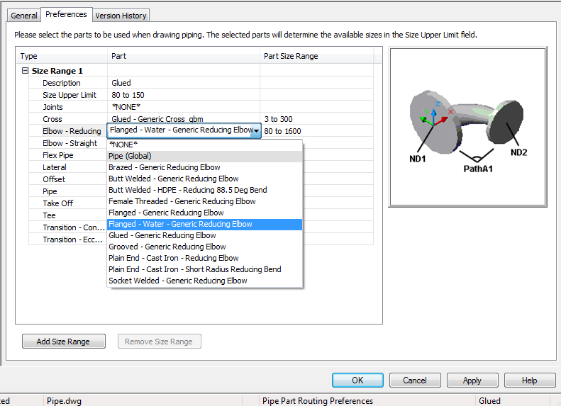

A pipe part routing preference includes one or more size ranges for pipe parts and fittings, such as elbows, tees, laterals, and transitions. The software organizes the size ranges based on nominal pipe diameters. You can use pipe parts and fittings in a specified size range as you lay out the pipe run. The following example shows the routing preferences for Glued. Notice that the available Pipe parts are organized based on material type for US Imperial and US Metric profiles.
Routing preferences, showing parts organized based on material type

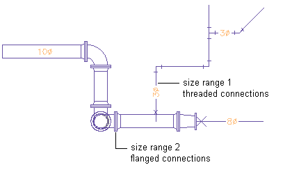

Multiple size ranges provide more flexibility in your piping designs. For example, assume a design specification for a chilled water system requires commercial steel pipe with threaded connections for all pipe sizes 3'' and lower. The system also specifies commercial steel pipe with 150 class, weld neck, flange connections for pipe sizes 3 1/2'' and higher.
When you configure a routing preference for a particular specification, the appropriate fittings are automatically inserted into the piping layout. Auto layout can generate different routing solutions, and prompts you to select the best alternative.
Pipe run drawn using a particular routing preference (Top view, Mechanical - Pipe by Size display configuration)

Pipes and fittings in a size range must have common nominal sizes in a routing preference that you can use in a pipe run. The following conditions apply to size ranges:
For example, when creating a routing preference, you select a pipe with sizes that range from 1/8” to 60” and an elbow with sizes that range from 1” to 24”. Because the lower limit of the size range is set to 1”, you can select an upper limit as high as 24”.
Size range details appear on the Properties palette when you add a pipe segment to a pipe run. The nominal sizes are grouped based on the size ranges for the selected routing preference.
