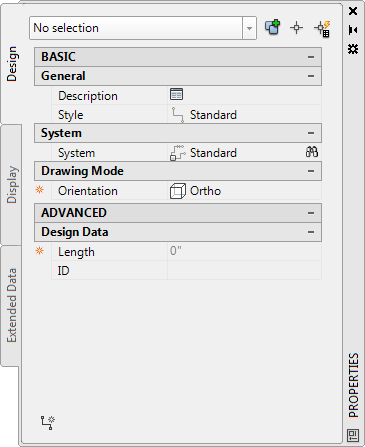

To add schematic lines in orthographic mode
If necessary, scroll to display the tool. Because tools contain pre-configured properties for the objects they create, you might not need or be able to specify some of the schematic line properties referenced in this procedure.
You can select from the styles in the current drawing.
You can select from the systems in the current drawing.
The currently selected schematic line style determines the list of available IDs.
