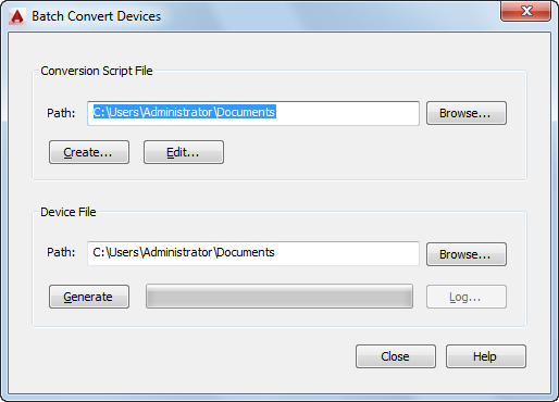

The software displays the Batch Convert Symbols dialog box.
The symbol conversion script contains the style settings to use, as well as references to the drawings that contain the AutoCAD® blocks to use for the style views.

| create a script | click Create, and create the script using the Symbol Conversion Script dialog box. For more information, see Creating Symbol Conversion Scripts. |
| use an existing script, such as a customized version of a script generated from converting existing schematic symbol styles to blocks. | click Browse, select the script, and click Open. Note: To make changes to the script prior to using it, click Edit, and modify the script using the Edit Symbol Script dialog box. For more information, see Modifying Symbol Conversion Scripts.

| create the drawing | in the Select File dialog box, specify the location for the new drawing, enter a name, and click Save. |
| overwrite the contents of an existing drawing | in the Select File dialog box, select the drawing, click Save, and then click Yes to confirm that the contents of the drawing can be overwritten. |
The software creates the schematic symbol styles using the conversion script and the block definitions from the referenced drawings.
