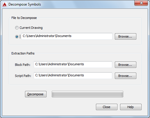

  1. Click Manage tab MEP Content panel Decompose Symbols .
  2. In the Decompose Symbols dialog box, for File to Decompose, select the drawing (DWG file) that contains the schematic symbol styles to convert:
    If you want to… then…
    convert the schematic symbol styles in the current drawing open in AutoCAD MEP click Current Drawing.
    convert the schematic symbol styles in a drawing stored locally on your computer click the radio button beside the file path, click Browse, select the drawing file, and click Open.
  3. For Block Path, click Browse, and select the folder in which to place the drawings that contain the AutoCAD blocks used by the views in the schematic symbol styles. Click OK.
    If the selected folder already contains drawings, then during the conversion process, you will be prompted about overwriting drawings with the same name.
    Note: Like all AutoCAD® blocks, the blocks in the output drawings are stored in an invisible data area called the block definition table. For more information, see .
  4. For Script Path, click Browse, and select the file name of the symbol conversion script to create:
    create a new script in the Select File dialog box, specify the location for the new script, enter a name, and click Save.
    overwrite the contents of an existing script in the Select File dialog box, select the drawing, click Save, and then click Yes to confirm that the contents of the drawing can be overwritten.
  5. Click Decompose.
    The software converts the schematic symbol styles into the blocks used by the style views and generates an associated script based on the style definitions.
