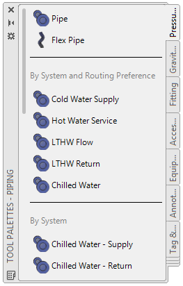

An object tool inserts an object, such as a duct or a pipe, into a drawing. When you add an object with a specific object tool, the object has the settings that are defined in the tool, which facilitates the design process and enhances consistency across your project drawings.
Object tools for adding piping objects
