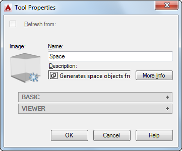

  2. Right-click the new command tool, and click Properties.
  3. For Name, enter a name for the new command tool.
  4. For Description, enter a description of the tool function.
  5. For Command, enter the command to execute when the tool is selected.
