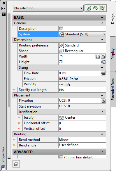

Add the basic properties of a duct using the properties palette.
By default, Basic properties are displayed in the Duct Properties palette.

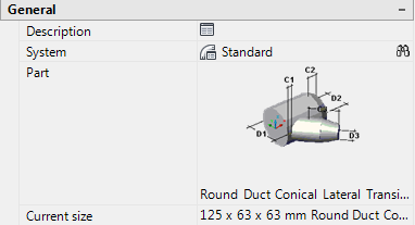

 ***Part  |
Click the image next to part to open the Select a Part dialog box. | |
| ***Current Size |
 Choose one of the sizes proposed in the drop-down menu. All sizes are standardized.  |
![]() General User Interface for Duct fittings  |
| Dimensions | Action | Selections |
| Routing preference | Selects a routing preference for the duct object in the current drawing. | Standard (default); selections derived from the catalog |
| Shape | Specifies the shape for the selected object. | Rectangular (default); thereafter last used shape |
| Size | Selects a size within the range specified in the current routing preference. There are different default size parameters, depending on the selected shape.
Last used value selected |
| Calculate Size | Calculates the sizes of the duct based on the Flow Rate, Friction, Roughness and Density. If a rectangular or oval shape is selected, one size has to be fixed to calculate the other one.  Note: For more information, see Duct Size Calculator.
 Size lock   |
 Prevents the size value from being changed.  |
| ***Connections | Customize the sizes of the fitting you want to add. | |
| *Flow Rate | Flow Rate is read from MvParts that are connected to the Duct Run or can be entered. | 0 (default). Flow Rate will be automatically refreshed if the Duct is connected to a MvPart. |
| *Friction | Shows the value for friction of the selected object based on the definition in the Duct System Definitions section in the Style Manager (Read-only). | |
| *Velocity | Shows the value for velocity of the selected object based on the definition in the Duct System Definitions section in the Style Manager (Read-only). | |
 Cut Length  |
If Yes is specified, then Cut Length lets you specify a dimension. Selecting No hides the Cut Length property. |
 No (default)  |
| Placement | Action | Selections |
 Elevation  |
 Specifies a Z value (elevation) above or below the XY plane of the current user coordinate system (UCS).  |
 0 (default), thereafter last used elevation  |
 Elevation lock   |
Prevents objects of one elevation from snapping to objects of another elevation. |
 Start elevation  |
 Specifies an elevation for connector 1 on the duct object. Start elevation is the same value as Elevation.  |
 0 (default)  |
| Justification | Action | Selections |
 Justify  |
 Orientates the justification of the duct object.  |
 Horizontal offset  |
 Specifies a placement offset in the horizontal direction from the insertion point.  |
0 (default); thereafter last used value |
 Vertical offset  |
 Specifies a placement offset in the vertical direction from the insertion point.  |
| Routing | Action | Selections |
 *Bend method  |
 Select the desired Bend method. Choose either Elbow, Offset or Transition Offset.  |
 *Bend method lock   |
 Prevents the bend method from being changed. If you do not lock the offset or transition - offset bend method, then the setting reverts to elbow after one instance of the selected bend method is inserted in the duct run. Note: Appears only if the offset or transition - offset is chosen.
 *Bend angle  |
 Specifies the angle to constrain the routing in the duct run.  |
 The bend angle varies, depending on the values that are defined in the catalog content.  |
 *Bend angle lock   |
 Prevents the bend angle from being changed. The Bend angle lock button appears only for user defined angles.  |
 **Segment  |
 Specifies the layout method for the flexible duct.  |
 **Radius factor  |
 If Line is selected for Segment, radius factor lets you specify a radius value.  |
 *Branch fitting  |
 Specifies the way to connect ducts.  |
