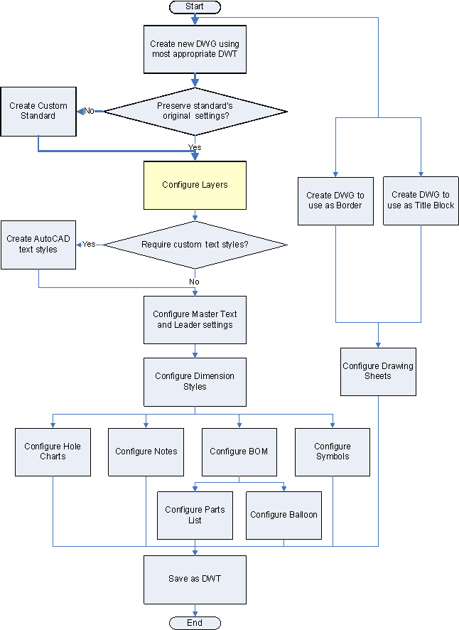

Where am I in the flowchart?

Company XYZ has been using AutoCAD for many years and has established guidelines on the usage of layers. They require AutoCAD Mechanical layers to follow the same guidelines.
Layer Renaming
They change the “AM_” naming convention to match the names they use currently. In addition, some of the layers have different color, linetype, and lineweight properties, requiring modification to the defaults.
