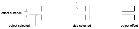

Creates concentric circles, parallel lines, and parallel curves.
This command uses the AMOFFSETLAYMODE system variable. “Normal” mode (AMOFFSETLAYMODE=0) creates offset objects on the same layer as the original object. With “Current layer” mode (AMOFFSETLAYMODE=1), the program offsets objects to the current layer.
The following prompts are displayed.
Specifies how far from the existing object to create the new object. You can specify multiple values separated by the "|" character. For example, to create objects at distances of 0.125, 0.25, and 0.5 from the existing object, specify 0.125|0.25|0.5.
