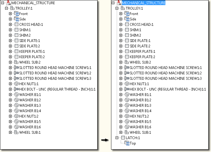

When you right-click in the browser to create a new component, without selecting an existing component node, the new component node is added to the top level of the browser tree.
In the following example, the part, LATCH, is nested directly below the root node.

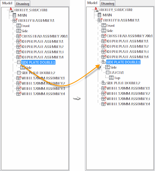

When you right-click a component node, or any of the folders under that component node, and use the context menu to create a new component, the new component is nested under the selected component.
In the following example, the component node SIDE PLATE DOUBLE was right-clicked and the context menu was used to create the new part LATCH. The result is that LATCH is nested under SIDE PLATE DOUBLE, and SIDE PLATE DOUBLE promotes to an assembly.
