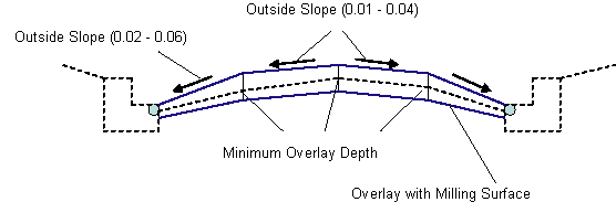

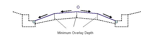

The resulting overlay links from the previous steps are checked for being within the slope tolerances for the outside and inside lanes. If the slopes are within the tolerence, then the case is a simple overlay as shown in the following diagram.
If overlay links are too steep, or if the Maximum Breakover is exceeded at the centerline, or the Min Crown Deflection is not obtained, some or all links are flattened to their maximum slopes. Milling surfaces are inserted to hold the minimum overlay depths at the quarter points and centerline.
If overlay links are too shallow, the depth of overlay is increased to achieve the minimum slopes. If this results in too much breakover, further adjustments and milling may occur. The following diagram explains overlay with milling case:

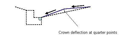

A positive slope may be allowed on one inside link if the other inside link has a negative slope, as shown below.

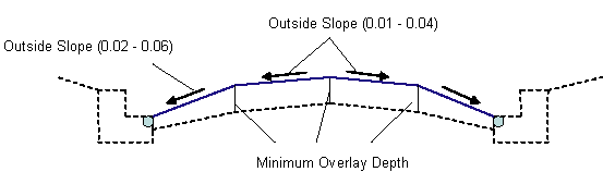

Coding Diagram
