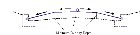

The resulting overlay links from the previous steps are checked for being within the slope tolerances for the outside and inside lanes. If the slopes are within the tolerance, then the case is a simple overlay as show in the following diagram.

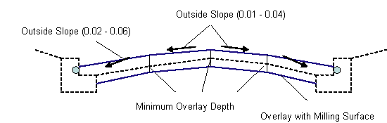

If overlay links are too shallow, the depth of overlay is increased to achieve the minimum slopes. If this results in too much breakover, further adjustments and milling may occur. The following diagram illustrates the overlay with milling case.

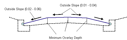

A positive slope may be allowed on one inside link if the other inside link has a negative slope, as shown below.
