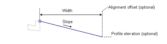

Behavior
The link is added in the direction of insertion starting at the attachment point and going the given width and slope. If an offset horizontal alignment name is assigned to the Width during corridor modeling, the width of the lane will vary to match the offset of the alignment. If a profile name is assigned to the Slope, the slope is adjusted to match the profile elevation at the end of the link.
This subassembly includes an optional input parameter named Use Superelevation Slope that lets you specify to use the superelevation slope for the shoulder. This parameter can be set to a) Outside shoulder slope, b) Inside shoulder slope, c)Outside Lane, d)Inside Lane, or e) None. None is the default setting.
Layout Mode Operation
In layout mode, this subassembly displays the link at the given width and slope.
