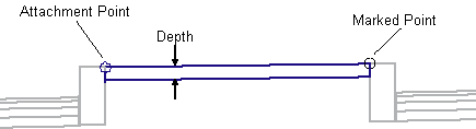

This subassembly inserts links for a constant-slope raised median between two points.
Use the MarkPoint subassembly first if the connecting point has not already been marked.
The attachment point may be at either edge of the median finished grade. The marked point must be at the opposite edge.

Marked Point
Name of the marked point on the median edge opposite the attachment point
String
None
Depth
Depth of the median cap. May be zero for an unpaved median
Numeric, positive
0.100 m
0.333 ft

The top of median link is inserted between the attachment point and marked point. If a non-zero Depth is given, the bottom of median link is inserted parallel to the top, and vertical links are added to close the shape.

P1, P2
None
Edges of median on finish grade
P3, P4
L1
Top
Top of median
L2
Datum
Bottom of median
L3, L4
None
S1
Median
