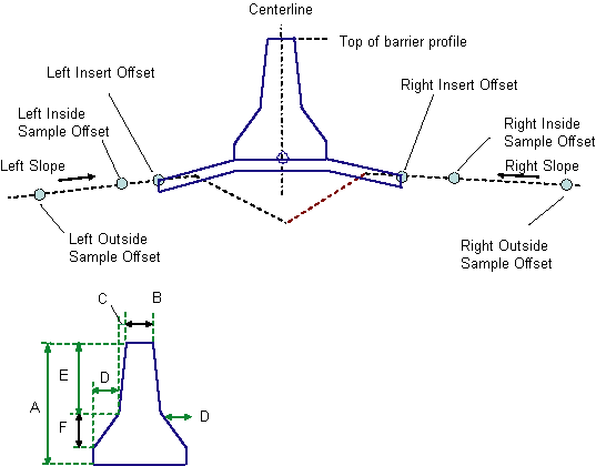

This subassembly widens an existing divided highway by extending from the travel lane edges inward over a depressed median, with a symmetrical barrier at the centerline. The median slopes may vary somewhat from the existing slopes to make both sides meet at the centerline, or to hold the top of the barrier to a profile.
The attachment point is at the midpoint of the base of the barrier.

Dimension A (mm or inches)
Height of the barrier from the base on the high side of the median to the top of the barrier.
Numeric, positive
810 mm
32 in
Dimension B (mm or inches)
As shown in diagram.
Numeric, positive
232
9 in
Dimension C (mm or inches)
Numeric, positive
59 mm
2 in
Dimension D (mm or inches)
Numeric, positive
125 mm
5 in
Dimension E (mm or inches)
Numeric, positive
557 mm
22 in
Dimension F (mm or inches)
Numeric, positive
178 mm
7 in

Top of Barrier
May be used to tie the top of barrier to the elevation of a profile. Dimension E may vary to achieve the calculated barrier heigh. The following object types can be used as targets for specifying this elevation: profiles, 3D polylines, feature lines, or survey figures.
Optional
Left Insert Offset
May be used to calculate the offset of the left insert point from an alignment. The following object types can be used as targets for specifying this offset: alignments, polylines, feature lines, or survey figures.
Optional
Left Inside Sample Offset
May be used to calculate the offset of the left inside sample point from an alignment. The following object types can be used as targets for specifying this offset: alignments, polylines, feature lines, or survey figures.
Optional
Left Outside Sample Offset
May be used to calculate the offset of the left outside sample point from an alignment. The following object types can be used as targets for specifying this offset: alignments, polylines, feature lines, or survey figures.
Optional
Right Insert Offset
May be used to calculate the offset of the right insert point from an alignment. The following object types can be used as targets for specifying this offset: alignments, polylines, feature lines, or survey figures.
Optional
Right Inside Sample Offset
May be used to calculate the offset of the right inside sample point from an alignment. The following object types can be used as targets for specifying this offset: alignments, polylines, feature lines, or survey figures.
Optional
Right Outside Sample Offset
May be used to calculate the offset of the right outside sample point from an alignment. The following object types can be used as targets for specifying this offset: alignments, polylines, feature lines, or survey figures.
Optional

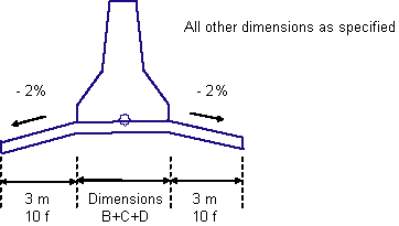

Layout Mode Operation
In layout mode, a median and barrier are drawn with the fixed dimensions as shown in the following diagram. This is the same figure that is drawn in layout mode for the OverlayMedianAsymmetrical subassembly.
