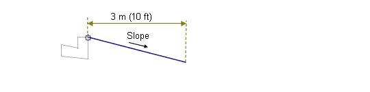

Layout Mode Operation
In layout mode, this subassembly displays the link at the given slope for a horizontal distance of 3 meters or 10 feet.

Coding Diagram
