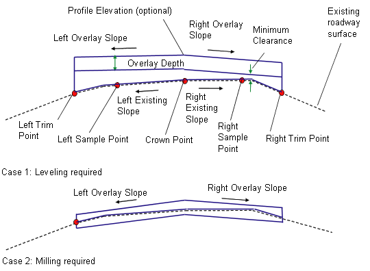

Behavior
This subassembly inserts parallel links defining the top and bottom of an overlay layer on each side that join at the crown point. The links are inserted from the Crown Point Offset to the Left and Right Trim Offsets.
Overlay Slopes
The slope of the Existing Surface on each side is determined betweenthe crown and sample points. The slopes of the overlay layers aredetermined by the following steps:
  1. If the Overlay %Slope input is given as M, then the overlay slope matches the slope from the Crown Point to the Sample point.
  2. If the Overlay %Slope is given as S, then the overlay uses the outside lane superelevation slope defined for the corridor alignment.
  3. If a numeric value is given for the Overlay %Slope, the given value is used.
  4. If a numeric value or the superelevation slope is used, the overlay slope is compared to the existing slope between the sample points. If the difference exceeds the Slope Tolerance value, the design slope is adjusted up or down by the Tolerance value to make it more closely match the existing slope and minimize the amount of leveling or milling. Slope adjustment does not occur if the Slope Tolerance is zero.
Overlay Elevations
The elevations of the overlay points are determined as follows:
  1. If the Use Profile value is True, the elevation of the corridor profile is held at the Crown Point offset on the top of overlay. The overlay is extended to each side at the overlay slopes to the Left and Right Trim offsets, and parallel links are inserted for the bottom-of-overlay. Any areas above the existing surface and below the bottom-of-overlay are stored as closed shapes with code “Level”. Areas below the existing surface and above the bottom-of-overlay are stored as closed shapes with code “Mill”.
  2. If the Use Profile value is False, the bottom-of-overlay link on each side is shifted vertically to hold to the Minimum Clearance above or below the existing surface. A positive Minimum Clearance creates a leveling area above the existing surface and below the bottom-of-overlay. A negative clearance creates a milling area below the existing surface and above the bottom-of-overlay. The overlay links on one side are shifted vertically so that the links meet at the crown point.

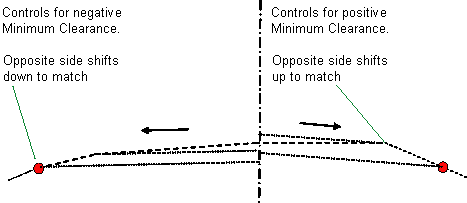

Minimum Clearance Point
The method of determining the point where the Minimum Clearance applies is shown in the diagram below.
  1. A vertical projection line is established at any arbitrary offset.
  2. Each point on the Existing Surface between the two trim points is projected back to the projection line at the Overlay Slope.
  3. The point with the highest elevation on the projection line is the control point for a Minimum Clearance value greater than zero. The one with the lowest is the control point for a Minimum Clearance value less than zero.

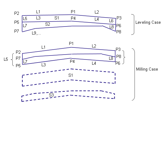

Layout Mode Operation
In layout mode, this subassembly displays the overlay layer positioned from any convenient point of attachment at a slope of -2%.
Point, Link, and Shape Codes
The following table lists the point, link, and shape codes for this subassembly that have codes assigned to them. Point, link, or shape codes for this subassembly that do not have codes assigned are not included in this table.
Point, Link, or Shape
Code
Description
P1
Crown
Crown on finish grade
P2, P3
EOV
Overlay edges on finish grade
P4
Crown_Overlay
Crown on bottom-of-overlay
P5, P6
EOV_Overlay
Edges of bottom-of-overlay
L1, L2
Top, Pave
Top of overlay
L3 – L6
Overlay
Overlay links. Note that L5, L6 go from the bottom-of-overlay to top-of-overlay in both the Leveling and Milling cases.
L7, L8
Level
Mill
Verticals from existing surface to bottom-of-overlay:
Level - For the Leveling case.
Mill - For the Milling case.
S1
Overlay
Area between the top and bottom of overlay. This overlaps the milling area (S3) for the Milling case as shown below.
S2
Level
Area above existing surface and below the bottom of overlay (Leveling case)
S3
Mill
Area below the existing surface and above the bottom of overlay (Milling case). This area overlaps the Overlay area as shown below.
Coding Diagram
