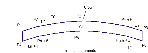

Point, Link, and Shape Codes
The following table lists the point, link, and shape codes for this subassembly that have codes assigned to them. Point, link, or shape codes for this subassembly that do not have codes assigned are not included in this table.
Point, Link, or Shape
Code
Description
P1, P3
ETW
Outside edges of lane on finish grade
P4, P6
ETW_Overlay
Outside edges of lane on the Base surface
P2
Crown
Crown point on finish grade
P5
Crown_Overlay
Crown point on Pave1
L1 to Ln
Top, Pave
Links connecting all points on finish grade
L(n+1) to L(2n)
Overlay
Links connecting all points on bottom of overlay surface
S1
Overlay
Area between finish grade and Pave1
Coding Diagram
