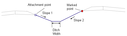

This subassembly creates a cross-sectional representation of a depressed median between the attachment point and a previously named marked point.
Use the MarkPoint subassembly first if the connecting point has not already been marked.
The attachment point is at the outside edge of either the left or right median ditch slope, and the previously defined marked point must be on the opposite outside edge. It does not matter which point is left or right of the other.

Slope 1
Slope (x : 1) of the link extending inward from the attachment point
Numeric
-4 ( : 1)
Slope 2
Slope (x : 1) of the link extending inward from the marked point
Numeric
-4 ( : 1)

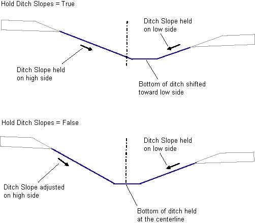

Hold Ditch Slopes
For the cases where the top-of-ditch-slope points are at unequal elevations, selects whether to hold the ditch sideslopes and let the position of the ditch shift, or to hold the ditch at the center and adjust the sideslope on the high side.
Selection list
Hold ditch sideslopes, shift ditch from center
Ditch Width
Width of the bottom of the median ditch (zero for a V-ditch)
Numeric, positive
0.6 m
2 ft

The locations of the attachment point and marked point are determined. The marked point may be either to the right or left of the attachment point. Links are extended inward at Slope 1 from the attachment point, and at Slope 2 from the marked point, until they intersect. If a ditch width is given, a horizontal bottom-of-ditch link is fit into the intersecting side slopes.
Ditch Slopes
The top of the ditch slopes may be at different elevations on the left and right sides, resulting in an asymmetrical ditch. There are two options for handling this situation. If Hold Ditch Slopes is set to True, then the Slope 1 and Slope 2 values are held on both sides, shifting the bottom of ditch away from the centerline towards the lower side. If set to False, the ditch bottom is centered about the midpoint offset between the tops-of-slopes, the given slope is held on the lower side, and the slope is adjusted to match on the higher side.
