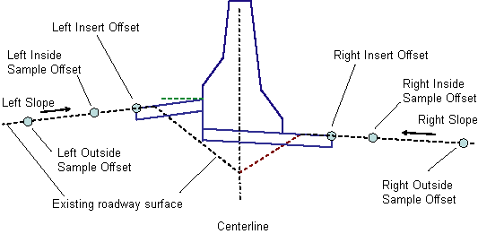

Left Insert Offset
Offset where the median extension layer begins on the left side.
Numeric
0.0
Left Inside Sample Offset
Offset of the inside sample point on the left side. The slope of the left side is calculated on the existing surface between the sample points.
Numeric
0.0
Left Outside Sample Offset
Offset of the outside sample point on the left side. The slope of the left side is calculated on the existing surface between the sample points.
Numeric
0.0
Right Insert Offset
Offset where the median extension layer begins on the right side.
Numeric
0.0
Right Inside Sample Offset
Offset of the inside sample point on the right side. The slope of the right side is calculated on the existing surface between the sample points.
Numeric
0.0
Right Outside Sample Offset
Offset of the outside sample point on the right side. The slope of the right side is calculated on the existing surface between the sample points.
Numeric
0.0

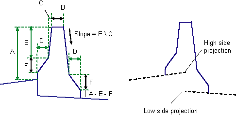

Dimension A (mm or inches)
Height of the barrier from the base on the high side of the median to the top of the barrier.
Numeric, positive
810 mm
32 in
Dimension B (mm or inches)
As shown in diagram.
Numeric, positive
232
9 in
Dimension C (mm or inches)
Numeric, positive
59 mm
2 in
Dimension D (mm or inches)
Numeric, positive
125 mm
5 in
Dimension E (mm or inches)
Numeric, positive
557 mm
22 in
Dimension F (mm or inches)
Numeric, positive
178 mm
7 in

Left Insert Offset
May be used to calculate the offset of the left insert point from an alignment. The following object types can be used as targets for specifying this offset: alignments, polylines, feature lines, or survey figures.
Optional
May be used to calculate the offset of the left inside sample point from an alignment. The following object types can be used as targets for specifying this offset: alignments, polylines, feature lines, or survey figures.
Optional
May be used to calculate the offset of the left outside sample point from an alignment. The following object types can be used as targets for specifying this offset: alignments, polylines, feature lines, or survey figures.
Optional
Right Insert Offset
May be used to calculate the offset of the right insert point from an alignment. The following object types can be used as targets for specifying this offset: alignments, polylines, feature lines, or survey figures.
Optional
May be used to calculate the offset of the right inside sample point from an alignment. The following object types can be used as targets for specifying this offset: alignments, polylines, feature lines, or survey figures.
Optional
May be used to calculate the offset of the right outside sample point from an alignment. The following object types can be used as targets for specifying this offset: alignments, polylines, feature lines, or survey figures.
Optional

Behavior
The left and right slopes are calculated between the sample points on each side. Lines from the cutout points are extended inward at these slopes to the centerline. The side with the highest elevation at the centerline determines the controlling side for the minimum height of the barrier.
The offset of the barrier base on the high side is calculated from the given dimensions. The overlay layer on the high side is extended from the cutout point to this offset.
The overlay layer on the low side is extended from the cutout point to the offset of the barrier base on the high side.
The barrier is constructed from the base point on the high side, closing to the top of the overlay layer on the low side, as shown in the diagram.
If a top-of-barrier profile is given as a target parameter, the height of the barrier is controlled by the profile. Dimension E may vary to achieve this height.
