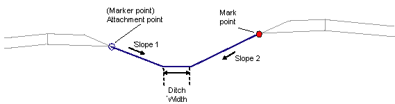

Behavior
The locations of the attachment point and marked point are determined. The marked point may be either to the right or left of the attachment point. Links are extended inward at Slope 1 from the attachment point, and Slope 2 from the marked point, until they intersect. If a non-zero ditch width is given, a horizontal bottom-of-ditch link is fit into the intersecting side slopes.

Point, Link, and Shape Codes
The following table lists the point, link, and shape codes for this subassembly that have codes assigned to them. Point, link, or shape codes for this subassembly that do not have codes assigned are not included in this table.
Point, Link, or Shape
Code
Description
P2
Ditch_In
Ditch
For non-zero ditch width, the edge of ditch closest to the attachment point.
If the ditch width is zero, use Ditch.
P3
RMedDitch
For non-zeroditch width, the edge of ditch closest to the marked point
L1 – L3
Top
Datum
Finish grade on unpaved shoulder and median links
Coding Diagram
