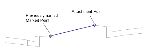

This subassembly is a general purpose utility to connect a link from the attachment point to a previously named marked point.
It can be used in a variety of situations, including connecting between adjacent roadways where the relative offsets and elevations vary, or across a gore area between converging roadways. Use the MarkPoint subassembly if the connecting point has not already been named.
Note:
In order for the LinkToMarkedPoint subassembly to work (draw) properly, it must be located below the MarkedPoint subassembly on the Construction tab of the Assembly properties. If the LinkToMarkedPoint subassembly is not located below the MarkedPoint subassembly on the Construction tab, you should select the Subassembly Group name in the Construction tab, then right-click and choose Move Up, so that the MarkedPoint subassembly is located above the LinkToMarkedPoint subassembly in the list.
The attachment point is at the beginning of the link. The link may go in any direction. The direction is determined by the location of the marked point relative to the attachment point. Be sure to name the marked point and set the marked point name in this subassembly.

A link is added from the attachment point to the given marked point.
Layout Mode Operation
In layout mode, this subassembly displays the link between the attachment point and the marked point.
