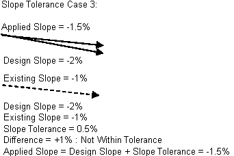

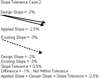

Slope Tolerance |
The value that the Overlay Slope is allowed to vary from its design value. The slope tolerance is not used if the Overlay Slope is given as M (see Behavior below for details). |
Numeric, positive |
0.5% |

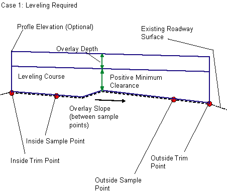

Use Profile |
Selects whether to hold the top of overlay at the inside trim point to the corridor profile elevation, or to set the vertical placement of the overlay layer based on the Minimum Clearance value |
Selection List |
Use minimum clearance |

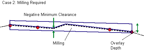

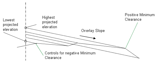

Minimum Clearance (+/-) |
The minimum vertical clearance between the existing surface and the bottom of the overlay layer. A positive value places the bottom-of-overlay link above the existing surface, creating a Leveling layer beneath the overlay. A negative value places the bottom-of-overlay link below the existing surface, creating a Milling layer that coincides with a portion of the Overlay layer. |
Numeric |
0.100 m 0.30 ft |
Overlay Depth |
The thickness of the overlay layer |
Numeric, positive |
0.100 m 0.30 ft |

The slope of the Existing Surface is determined between the inside and outside sample points. The slope of the overlay layer is determined by the following steps:

Minimum Clearance Point
The method of determining the point where the Minimum Clearanceapplies is shown in the diagram below.
