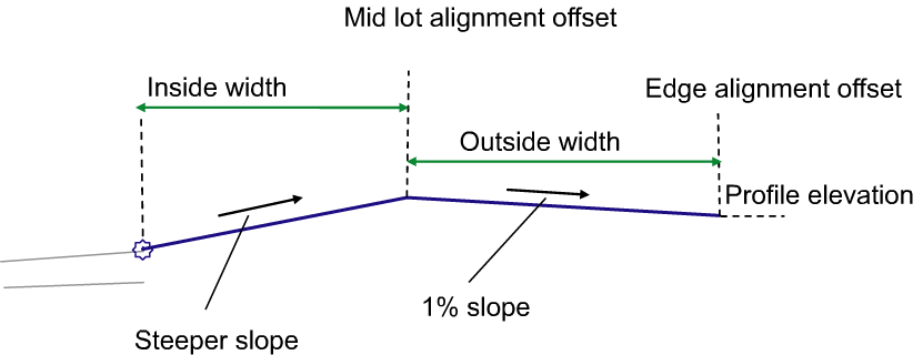

The following illustration shows an example of this subassembly being used when the target profile elevation at the back of the lot is higher than the attachment point.

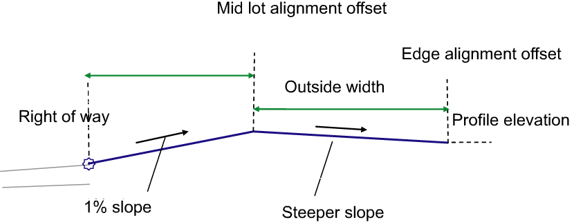

The following illustration shows an example of this subassembly being used when the attachment point is higher than the target profile elevation at the back of the lot.
