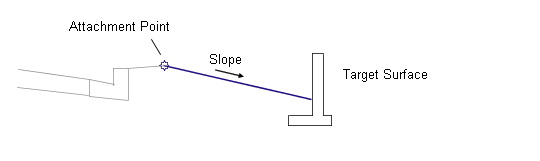

This subassembly is a general purpose utility to extend a link from the attachment point at a given slope to the closest intersection with a target surface.
The attachment point is at the beginning of the link.

Behavior
A link is extended to the left or right from the attachment point at the given slope until it intersects the target surface.
By default, a cut or fill link will be added from the attachment point to the target surface. If the link needs to be added only in cut or fill conditions, specify appropriately a value for the Add Link In property of the subassembly. If the cut link and fill links must be at different slopes, then add this subassembly twice, at the same attachment point, once for Cut Only and then again for Fill Only conditions, with slopes as needed.
This subassembly includes an optional input parameter named Use Superelevation Slope that lets you specify to use the superelevation slope for the shoulder. This parameter can be set to a) Outside shoulder slope, b) Inside shoulder slope, c)Outside Lane Slope, d)Inside Lane Slope, or e) None. None is the default setting.

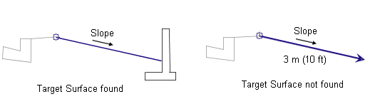

Layout Mode Operation
In layout mode, this subassembly attempts to find the intersection of the link, if the target surface was inserted by a previous subassembly. If an intersection is found, the link is displayed at the given slope to the surface. If not, the link is displayed at the given slope outward for a slope distance of 3 meters or 10 feet, terminating in an arrowhead pointing outward.
